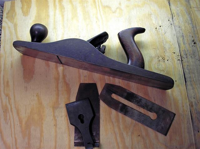

Here's my old Baily 5 1/2 that works great. I tuned it up and used the original blade. I was going to use a Hock but haven't needed to so far!
